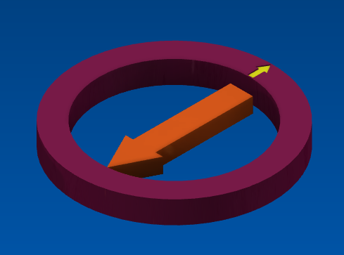

I'm not sure if this helps or not.  The attached two-part assembly (Inventor 2019 format) uses the rotation-type motion constraint coupled with an angle constraint with a resting position.  As currently set, it has six "rest" positions, but can be very easily modified for any number.

OK, here is the detent example in 2016 format.  This one has four detent positions, but changing that is as simple as editing the Rotation constraint and changing the ratio from 4 to whatever number you wish.

Hmmm.... on my system the ring can only rest in one of four positions.  If you drag it around, does it not jump to the nearest quarter?  It does this because the arrow part is constrained to snap back to zero, and is connected to the ring by a 4:1 rotational constraint.
But perhaps this isn't really addressing what you need.  Can you describe in a bit more detail what you want for your four-position indexer?  If you actually want to simulate the motion of the indexer by driving the input, that will be more complex, probably involving Simulation, which is a bit above my pay grade.  But for just constraining its rest positions while able to drag it from one position to the next, this does the job.

His solution works perfectly. I think you may have been rotating the wrong part (the arrow part can be made invisible, as it is there only to help the functionality).

Here is your indexer assembly revised with the detent function added (2016 format).  I simply added the Detent.ipt part that I used in my sample, and constrained it as I did in the sample.  Again, this allows the indexer to be dragged in its one degree of freedom (rotation), but when let go, will snap to the nearest of four angular positions.  This is because it is coupled (by Rotation constraint) to the Detent part, which will rest in only one angular position.
