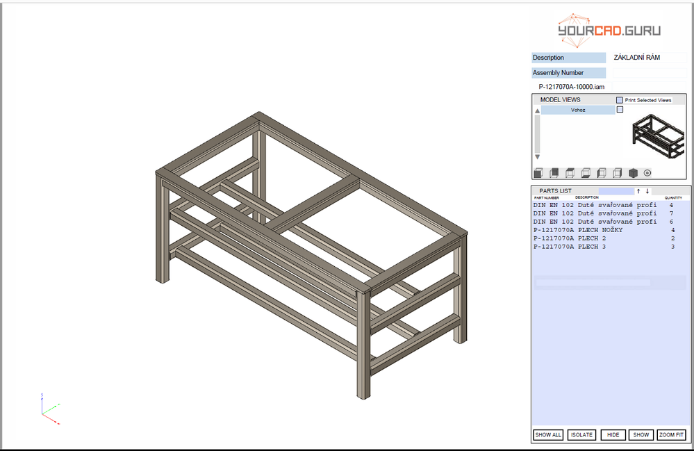

So part of it is the weldment ... (and why I asked in the prior when I saw your image, it looked familiar)
there is a known issue with weldments inserted into another assembly ...
might be something @johnsonshiue needs to look at more ...
Mike Davis
Message 10 of 22
mdavis22569
Frame works fine ....outside of being in another assembly:
But if I put it into another assembly:
Mike Davis
Message 11 of 22
johnsonshiue
Hi! I have seen this behavior before. Somehow the visible components are exported but turned off by default in the 3D PDF file. If you click on the tree view in Acrobat reader, you will see quite a few components are unchecked. The behavior does not make sense. I will work with project team to understand it better.
