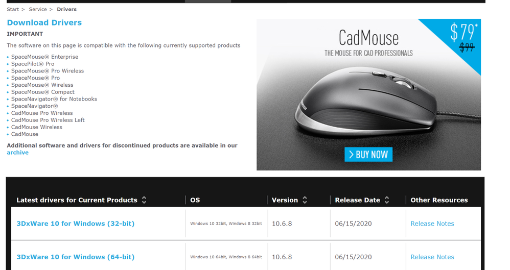

Message 8 of 10
mdavis22569
Should be at 10.6.8
https://www.3dconnexion.com/service/drivers.html
Mike Davis
Message 9 of 10
nick.vansonsbeek
that driver only works with the new spacepilot pro not with the old spacepilot.
Message 10 of 10
mdavis22569
might be time to upgrade then ...
