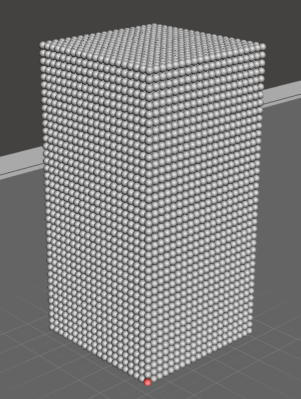

I am trying to create a 3D cube of spheres, much like the picture attached. Best I could do was find: https://forums.autodesk.com/t5/inventor-customization/add-in-to-generate-a-3d-array-of-spheres/m-p/5... with no answer.

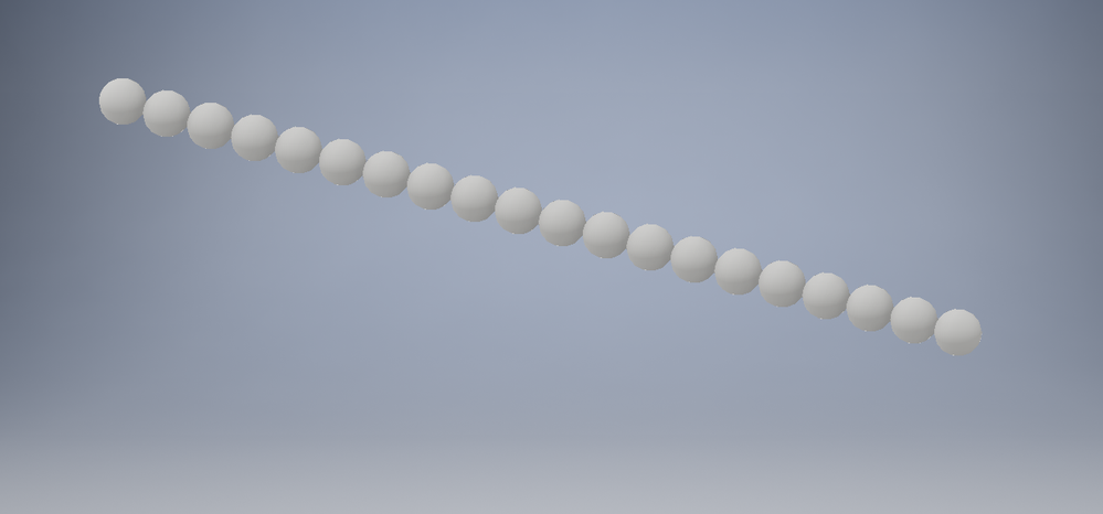

I have made a single array of 20 spheres, but would like this to form a 20x20x40 array of spheres. Is there an easy way to do this?

Hi! I thought you could do it with pattern of pattern. The trick is to pattern the sphere as a body but join occurrences together. Make sure Compute method is set to Optimized (click the double arrow to expand the dialog). Then repeat it in Z direction.

You could do this with a formula.  Set "count" for depth to the number of spheres per side of the cube.  Then make a pattern making it "count" number of occurrences.  Then make another pattern horizontal "count" wide and vertical "count" high.
Shaazaaam you can have infinite variety of sizes of cubes.
P.S.
or make a different count(vert), count(horizontal), count(depth) and make it any rectangular size.

Perfect, this is exactly what I was looking for. Thank you so much!
