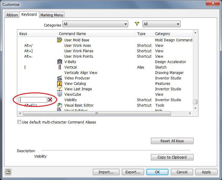

Ray_Feiler
Number 2.
You can create you own short cut.
Sorry, the wrong command is shown it this picture.
Product Design & Manufacturing Collection 2024
Sometimes you just need a good old reboot.
Message 5 of 9
James115
Wow that one's really handy thanks so much! I was actually thinking of downloading a program for macro's but that's not even necessary now 🙂

James115
Hey, I tried this but it doesn’t seem to do anything. And after I chose V as shortcut (alias), my other shortcuts stopped working. It got fixed by unchecking ‘Use default multi-character Command Aliases’, so now I won’t get the Command alias input in the .dwg anymore and my B for Balloon works again. But in the .iam it still starts the Command alias input and doesn’t recognize V as an correct input. Any idea how I’m able to assign the visiblity to V or Alt+V or something?
