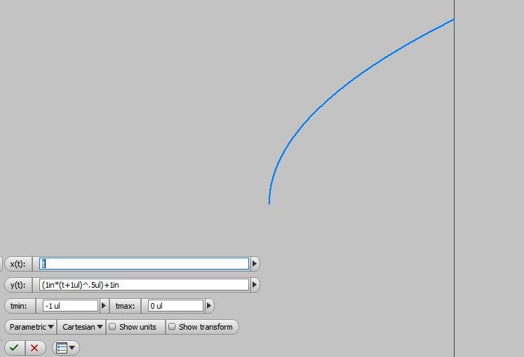

I am trying to plot a square function using 2D equation curve tool. but I am getting error as shown in the attached image.
Error I get is "Cannot evaluate at x^y if x is zero and y is less than or equal to zero, or if x is zero or negative and y is not an integer"
this function should be valid in the interval specified. I attached screenshot from wolframalpha for that.
Is inventor not able to calculate value when t =0? is there anyway around this?

This works:
PDSU 2016
Thanks for replying.
I figured out the problem. Apparently it does not work with 2014 version of the inventor.
