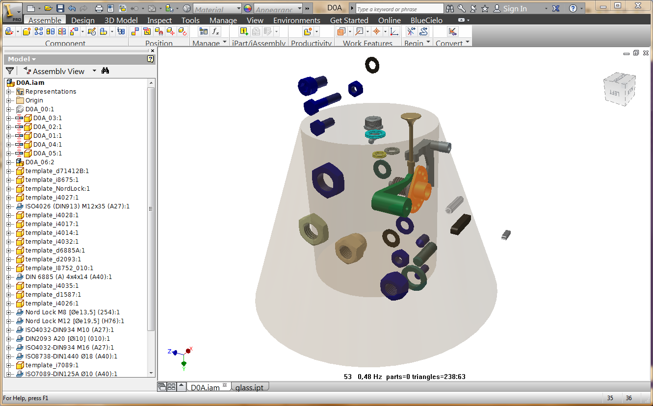

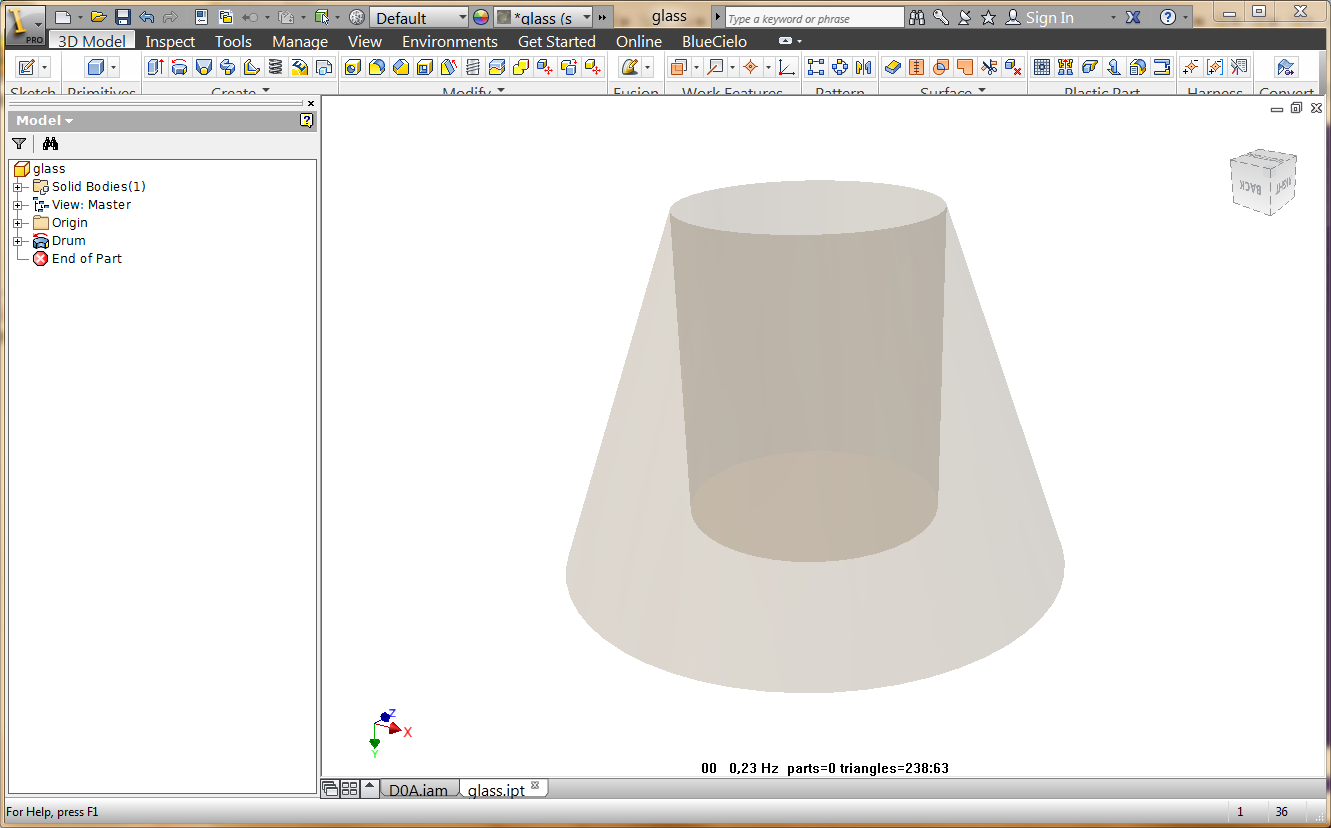

again something not working: has anybody managed to make a "transparent appearance"?
All the "glass" materials from inventor libraries, with a wonderful transparent vase icon, are nice only in the icon: when you apply the color the get not clear any more.
Then I tried to open an old component that WAS transparent.
This one has an appearance override, and I imagine that I could use that override to create my other glassy styles...
of course not possible: in appearance editor no traces for the glassy override...
Anyone managed to make a glassy (transparent) material in inventor 2013??
It's insane... this is really not acceptable

The Polycarbonate (Clear) is what I use for transparent parts.

...thanks Mike, it worked out.
In principle you always need to make copies of styles present in the Autodesk libraries... thanks God they said that you can migrate old libraries... they are wasting me so much time.

What's the line "xxx HZ; yyy parts; zzz triangles" in the bottom of graphic window?
Is it somewhat related to some 3rd pard rendering software?

freesbee
[HKCU\Software\Autodesk\Inventor\RegistryVersionX.0\System\Preferences\Scene Manager\Debug]
"Post Statistics"=dword:00000001
realtime monitor graphical performances, nothing to do with rendering
(careful: substitute "X" with your proper release, 17 for 2013, so far working on all versions since Inventor 9)
