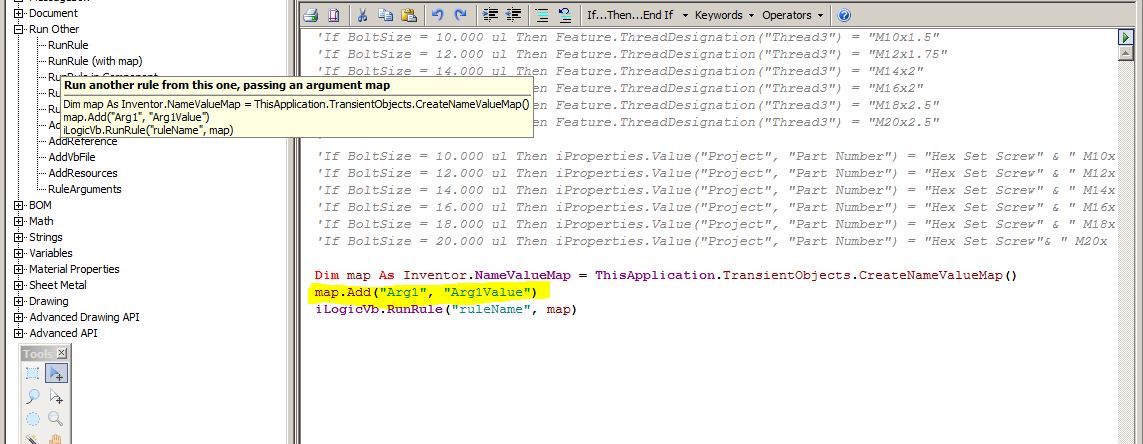

I have a rule in the top assembly to update & want to run this as a final 'clean up' after various rules have run in sub assembly parts.
I have a rule within a part at the end of the line. I want this rule to goto the top assembly & run the 'Update' rule.
Could someone please provide an example of how this rule should be applied?

Thanks for the reply.
I don't understand  map.Add("Arg1", "Arg1Value").
The top rule is called "Update" - changed  "ruleName" to Update  - resulting in:
If (ThisApplication.ActiveDocument Is ThisDoc.Document) Then Return
Dim map As Inventor.NameValueMap = ThisApplication.TransientObjects.CreateNameValueMa​p() map.Add("Arg1", "Arg1Value") auto = iLogicVb.Automation auto.RunRuleWithArguments(ThisApplication.ActiveDo​cument, "Update", map)
& found these errors:
Rule Compile Errors in Update, in Hex Head Bolt.ipt
Error on Line 3 : End of statement expected.
Error on Line 4 : Name 'map' is not declared.
Error on Line 6 : Comma, ')', or a valid expression continuation expected.
Cheers
