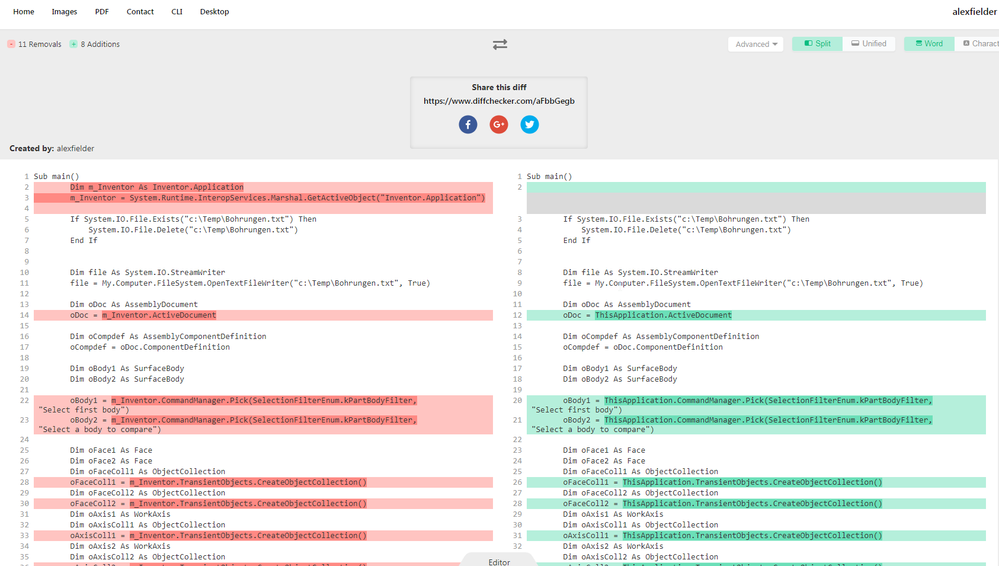

If you have some sample files or a pack & go assembly you can share that might help me/anyone else test that my above iLogic statement is in fact true.
Alex.
Message 3 of 29
Align error.PNGThis is the error I'm receiving. i assume it has to do with the way it is calling out the objects. thank you for the help
Message 4 of 29
AlexFielder
That's easy* - simply change the first method to "Sub Main()" and it'll work.
This usually happens when you copy in a pure VB.NET (or VBA) rule. iLogic will throw this message as it effectively compiles the rule into a .dll of its own, so needs "Sub Main()" to know where the entry point is when you're using "Sub" or "Function" methods.
*It's only easy if you know how.
Message 5 of 29
Thank you for all the help i have minor issues now, sub main was the key to get it working.
so know  all the code is not triggering its giving an error

It's probably due to the VB.NET code originally having been written to control Inventor from an external .exe - here's a diff I just made with my suggested changes:
https://www.diffchecker.com/aFbbGegb
and here's the changed code:

I basically changed all the references to m_Inventor to ThisApplication. It should work with these changes, but let me know if not.

Just got back to this project, I'm having an error after I opened original template back up
from all that have read online it has to do with how I'm choosing my document.
I tried placing this code and I received line errors after that.
  oDoc = m_Inventor.ActiveDocument is there another way this could be written
oDoc = thisapplication.activedocument
Message 19 of 29
AlexFielder
This is exactly what I changed when we last spoke. I don't think you clicked the "diff" link I shared which showed this:
diff link is here once again for your perusal: https://www.diffchecker.com/aFbbGegb
Message 20 of 29
so anywhere I have m.invetor I need to use ThisApplication. since I did not change all the places I was throwing an error correct?. I only replaced the first one that would explain the reason I was getting the error. I'm going to try it now
