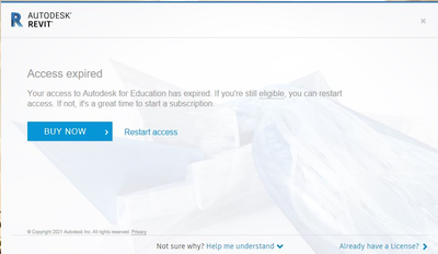

Hi there,
I have a student account that allows access to all Autodesk products until Feb 2022, currently, I have no access to any Autodesk Software as apparently, my licences have expired when my account clearly states that it is valid until Feb 2022, I have installed Revit and AutoCAD, redownloaded them and once again the issue of my Autodesk for education license has expired message keeps popping up, see below
After following the steps of restarting my access and proving that I am eligible the same cycle keeps happening where I simply do not have access to Revit or AutoCAD!!!
This is very annoying as I am in the last year of my University Degree and due to a pandemic called Covid-19 have no access to university computers or their license keys.
Any Idea??

Great News I've fixed the issue.
Once I had deleted all Autodesk software from my laptop even the material libraries and the Autodesk Desktop App, I created a new Autodesk account with a new email and linked that to my University, once that had been verified I redownloaded the Autodesk desktop app and signed into that account (only this account no other accounts). I then used my new account to download the student software once again and for some reason I got an email to verify this occurring. I tried to install it at first but this failed so I recommend downloading instead and following the steps.
I hope this helps and this is definitely an issue that Autodesk NEED to solve ASAP !!
