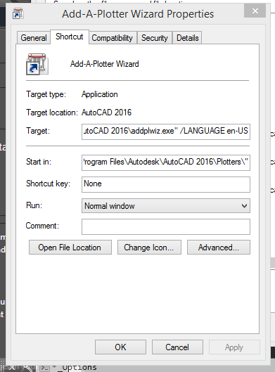

Hi @Anonymous
If you open AutoCAD, Select the Application Button (Big 'A') then select Print > Manage Plotters and it should open the location where the 'Add-A-Plotter Wizard' is. Right click the shortcut and go to Properties... check the Target and Start In Location. Make sure they are the same version as the version your running.
For instance, im running 2016 so these are the paths...
Target = "C:\Program Files\Autodesk\AutoCAD 2016\addplwiz.exe" /LANGUAGE en-US
Start In = "C:\Program Files\Autodesk\AutoCAD 2016\Plotters\"
You could simply search for Add-A-Plotter Wizard in Windows Explorer.
As your having issues trying to get into this, you might want to check the following path... this is the default location but i think your previous post referred to another.
C:\Users\Duncan\AppData\Roaming\Autodesk\AutoCAD ****\R20.1\enu\Plotters (**** being the version)
Also it might be worth checking your options...
Usually AutoCAD will hang if a path cannot be found or a path is wrong, fix the paths and everything will work.
