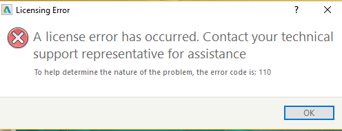

After fresh instalation of 3dsmax2017 I lauched the application and Autodesk Licensing window opened, I pressed "activate" and got this errorerror.PNG

Hello kaspis376XVPG and welcome to the Autodesk community!
It looks like you're getting Error 110 during activation. This error typically occurs when something in the licensing folder is corrupt.
The following instructions should help you resolve the problem:
For Mac, please uninstall your current version of Maya and install this Service Pack.
For Windows, please uninstall ALL Autodesk software and then delete the folder containing the licensing components and then re-install. Here are the steps to do this:
  1. Uninstall Autodesk software
  2. Delete C:\ProgramData\Autodesk\Adlm and all contents
  3. Delete the ADSKFLEX files in C:\ProgramData\Flexlm
  4. Re-install autodesk software.
