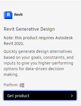

I have been trying to use the Generative Design feature in Revit 2021 with a student license but each time that I try to access it I get the message "Generative Design in Revit is only available to AEC Collection subscribers"(Image below)
I have checked in the Autodesk Students Software website and activated the "Revit Generative Design" package (image below), but it does not work
I only have access to the generative design package in Dynamo.
Any thoughts on this?
Thanks in advance!

Hello @Adolfo2.Moncayovisanzay
The Generative Design in Autodesk Revit is a new feature now available through the AEC Collection with Revit 2021. Under the "Individual"  tab on the Educational software program site the AEC collection is not listed, so it is not offered to individual students or educators.
