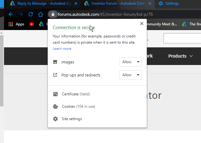

Hi, where do i get the full package download? Because when i try to install the program the errorr comes on the screen with this message: "product consists of multiple files. At least one file is missing or has not been downloaded yet".
Can anyone help me?
Message 11 of 11
leowarren34
Hi @tadej.trbanc,
Which Inventor version are you trying to install?
The cause of the issue is likely to be your browsers pop up blocker, which should be disabled for these web pages.
For Chrome this means: Click on the padlock on the search bar -> Site Settings -> Pop-Ups and redirects -> Allow
