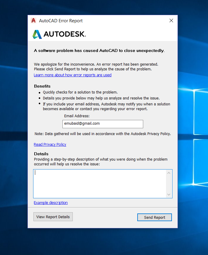

I have been using Auto Cad-2016 since last one year, but recently I am facing a problem with auto Cad.
When I am using Auto Cad the software will close unexpectedly with some error message.
I have done many solutions like uninstall and re install, repair the soft ware, change the software version etc.., but still it is happening.
kindly requested to help me for this issue. Please find attached for your understanding.
Awaiting your response.
611 Views
Mark.Lancaster
@ubaidjamshi
This is a standard Autodesk crash report..  There's nothing that can help us determine what the problem is.  I might suggest running the reset to default for AutoCAD that's located in your Windows Start Menu/Autodesk/AutoCAD section.

Hello @ubaidjamshi
Thank you for posting to the forums, sorry you are encountering this issue you can run through these common solutions to help you resolve this.
  1. Sign in as Administrator or Create a New User Account (Full Control user permissions)
  2. Check the Operating System needed & the required updates by reviewing the system requirements for the software & Certified Graphics Card Drivers
  3. Make sure you have an updated graphics card driver by checking the manufacturer's website (Assign the correct Graphics Card)
  4. Temporarily disable your Antivirus software & Firewall
  5. Temporarily disable UAC on  Windows 7 or Windows 10
  6. How to reset the application to defaults
  7. Update your product with the latest service pack or Hotfixes by visiting the Autodesk website or account
  8. AutoCAD freezes, hangs, or crashes during startup (these steps can be used for all applications)
Let us know how it goes.
