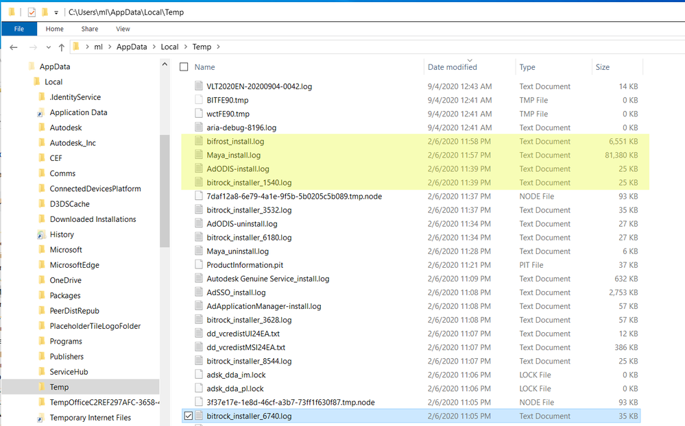

The installer creates log files in the %temp% folder. Can you please zip/rar/7zip that files and post them here, that we can take a look ?

Just an example of log files from my last Maya 2020 installation:
regards
Markus

@Anonymous  and I did a clean uninstall. then we installed the Autodesk License Service and installed Maya again.
Now it works.
regards
