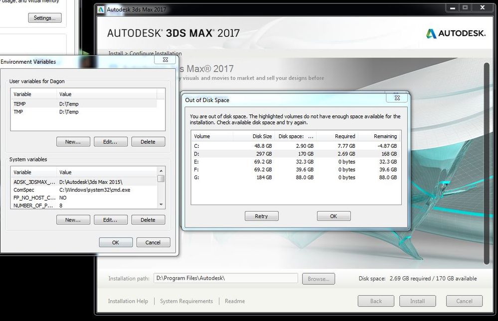

Why does the software require 7.7 gigs on my C drive to install less than 3 gigs to my D drive.
I carefully partition my hard drives, and there is not 7 gigs able to be freed on m y C drive. I leave about 5 gigs on that drive after windows, and keep everything on separate hard drives to enable easy reformatting.
This is the only application I have tried to install that could not make use of the terabyte of space on the rest of my physical hard drives.
It feels silly that I would need to re partition my hard drives, to put more wasted space on C drive, in order to install your software on my D drive.

There is a certain amount of files that must reside on the "C" partition to support user's profile and operating system information.
However its not 7.7GB of info.   To correct this issue, when you get to the installation screen where its asking for which application to install..  Simple expand (click on black arrow) each application that is getting installed and redirect all paths in that section to the partition that you want.

Mark is right.  Installation space will generally be 2x the application space because it needs to expand the installation and log files into your %TEMP% folder during installation.  Moving those locations to another drive will also help with space issues.  All of those instructions and more are at the beginning of this thread.
It makes sense when you think about it logically.  You download a 1.5GB file onto your C:\ downloads folder from Autodesk.  Then you install it and it expands that file out to about a 3GB installation.  That 3GB installation then gets installed to your C:\Program Files.  Total working size would be about 7.5 GB, which then cleans back up to about 3GB + your original download.  You can move your download and temp locations to another drive and install on another drive and basically use a very minimal amount of space on C:\ drive.  Those would be basic profile settings, common files, etc.

dagontuVWRLM
I downloaded the installer to my D drive where I have 150 gigs free.
I started the installer from there.
I unchecked the sdk and other software options.
It tried to install to c drive without asking me, then popped up and said I did not have enough room.
So then I changed the installation path of the only thing selectable, which was the main application(3dsmax 2017) to d:\programfiles\autodesk
There were greyed out checkboxes for the material library, which I have zero interest in installing.
I could not uncheck them, and also could not change the path for them.
So then it said 7.7 gigs to c drive, and 2.59 or something to D drive.
I would really prefer to save and install everything to a selected drive letter from start of installation.
Most other large program files I install expand  to temp folders on the same drive, and some even let me specify which folder I want to use as a temp folder.
Options to have local preferences would also be great, in case I didn't want to use the appdata folder, which I have always hated navigating to in order to fix ini issues and other problems.
I have to go fix these for our artists all the time too, and their app data folders are hidden, ect... ect...
Sorry for my tone earlier, I had just spent a very frustrating time with the website trying to get something that apparently you have no way to get.
I have a standalone liscence for at home use from work with a serial key, and there was no way to get that added.
So I figured I might be able to put in the key, in the trial version. Then I had to sign up for a subscription, wait for it to get approved, try to install, and then find out I cannot install it.

@aaposwrote:
If you're cursed with an absolutely tiny SSD boot drive, like me, where you phyically can't clear out enough space to complete the installation, you can try my completely unsupported workaround, that worked for me.
  1. Let the webinstaller complete downloading the installation packages.
  2. Exit installation.
  3. Move C:\Autodesk to your larger hard drive
  4. Create a filesystem link (either a junction or more preferrably a symbolic link) to C:\Autodesk.
  5. Restart the webinstaller, which will in turn launch the installer.
  6. Continue as normally
The installer will notify you that you've moved the isntallation data, and that this is unsupported, but dismissing the window allows you to continue with the installation and complete it succesfully.
This allowed me to succesfully install the Entertainment Creation Suite Ultimate even though I have a teensy 40GB boot drive.

I recently installed AutoCAD on a non default Drive (G:/) because like others I have a small C:/ Drive just for my OS.
Now I want to install Inventor 2019. So I followed all the steps.
I changed the %TEMP% file to a Dir. in G:/,
I changed during the installation the paths for the libaries to G:/
I even created in C:/ a filesystem link to G:/
Everything didn't work out.
So i follwed the link posted somewhere above where it's mentioned to change in the setup.ini the DISKCOST Values to something like 50.
But... I still can't install it. It still says I need 12,5 GB of space in C:/ although I did everything to change the Dir. from C:/ to G:/.
Please, I can't be that hard. Really.
Message 60 of 64
TravisNave
Did you reboot after your changes?
