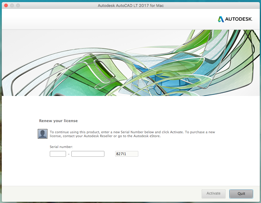

Please see the photo.
It's totally baffling me. Sign in works, but doesn't recognise that i have the licence and is going onto free trial mode.

natasha.l
Hello @Anonymous,
Thanks for being a member & posting to the community.
I would try to remove the files located in these locations to reset the licensing on a Mac & try to activate the product again.
All Autodesk Products will be effected when conducting these steps, just so you are aware.
You don't get a serial number when you renew your subscription (Mac)
  1. Close your Autodesk program.
  2. Delete the three (3) files prefixed with adskflex from the following folder:
     /Library/Preferences/Flexnet Publisher/FLEXnet
  3. Remove all files from the following folder:
    /User/username/Library/Application Support/Autodesk/ADUT
  4. Go to the following folder:
    /Library/Application/Support/Autodesk/CLM/LGS/<product key>_<product version>
  5. In this folder, do one of the following:
    • Open the LGS.DATA file, change the value to _STANDALONE, and save the file
      OR
    • Delete the contents of the folder & create a txt file with _STANDALONE in this folder
  6. When you launch your Autodesk software Enter the Serial Number
Let us know how this turns out.

natasha.l
Hello @Anonymous,
Try a Clean Uninstall for MAC then reinstall and activate. Also, make sure you are using 827I1 an I.
Please "Accept As Solution" if a reply has helped resolve the issue or answered your question, to help others in the community.
Message 9 of 10
I tried that already. No luck 😞
Message 10 of 10
The clean uninstall worked
