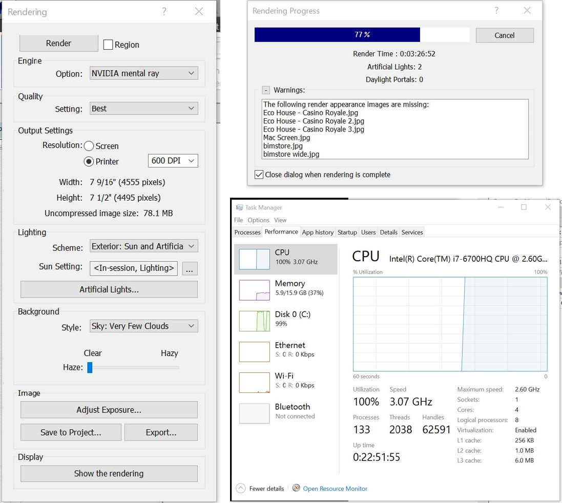

My DELL XPS 15 when testing Revit 2016 had outdated BIOS firmware which caused the CPU to cap at 1.6GHz (see in the video).  I updated the BIOS to the latest version and now the system is running at full 3.6GHz burst speeds.  Average CPU speed when using Revit was 3.2 GHz.
When rendering in Revit on the laptop, all levels of rendering can be handled by the existing laptop and its current configuration except the highest custom level settings when rendering at Printer resolutions of 300 DPI or higher.  When rendering with a custom setting of maximum, highest quality levels, Revit will process the rendering for approximately 3 hours and then fail stating not enough memory.  There is a knowledge-base (AKN) article regarding this found in THIS link.
Ways to prevent the above issue are:
  • Close all windows not needed in Revit prior to issuing the Render command
  • Close and restart Revit prior to issuing the Render command
  • Clear out the %temp% folder
  • Temporarily re-path a new TEMP folder for Revit
I currently have 16GB of DDR4 RAM on the laptop.  During the actual rendering process, my resource monitor shows my max RAM usage was 8 GB.  Total rendering time for “Best” setting was 9 hours using the Mental Ray Engine.  The total rendering time for “Best” setting was 16 hours using the Raytracer Engine.  When using the Raytracer engine, your network card will be “taxed” making doing any online work at the same time almost unusable.  Remember…the XPS 15 9550 laptop does not have a dedicated NIC port…only wireless card.  Rendering in the Cloud with Autodesk servers took 45 mins.
If your everyday work tasks do not involve extremely high levels of rendering or analysis, then this system will handle anything you throw at it.  However, if you are doing this sort of high end work, moving to the Xeon processors and Precision higher models is appropriate.  Albeit, the cost will jump up to at least $900.00 or more depending on the graphics card you finally settle on.
Here are some snapshots of the rendering process within Revit.  Please keep in mind that the results are based upon actual capture data DURING rendering (i.e. read/write speeds of SSD are much faster that reported).
