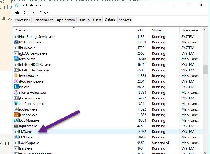

Anyhow bring up Windows task manager and select the details button and locate the process and right mouse click and select end process.

Message 8 of 13
Hey @Mark.Lancaster ,
thx for the screenshot on the LMS.exe >> I've tried this many times, but every time I "end process" on "LMS.exe" it pops back up as Running after about 3 seconds.  I can't get that task to fully end.  This makes me think that LMS.exe is running something else...or AutoCAD is running something in the back ground.  I've tried to "end process" on every Autoxxx program I can find in Task Manager....nothing works.  I have an email with a new 3-yr license but cant's get to the login part of the program.
I appreciate your helping to date, but I am just stuck in mud on this...
bw
