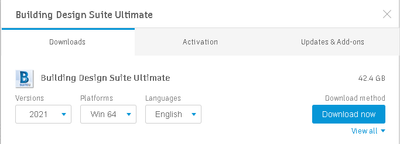

Message 6 of 11
Tony_Michniewicz
You should be able to download the sfx.exe files from the Products and Services section of the Autodesk Accounts Portal.  If you expand one of the product entries, there should be a View downloads link, which opens a dialog from which you should be able to download these files.

Hi Tony,
As promised, my follow-up.
First - SUCCESS! I downloaded the files again (it was actually the third time, as I had gone through exactly the same procedure twice before I came to this forum) and the install failed, for the third time. Either the originals are faulty or something happened three times in the downloading process. Who knows. I then used the Download Now function and it worked just fine. After the (very) lengthy installation, and the separate installation of 3D Max Interactive and InfraWorks (why separate?), the BDSU 2021 installation is done. I've requested a hard copy of everything from Autodesk, so that I have the installable files as a backup.
