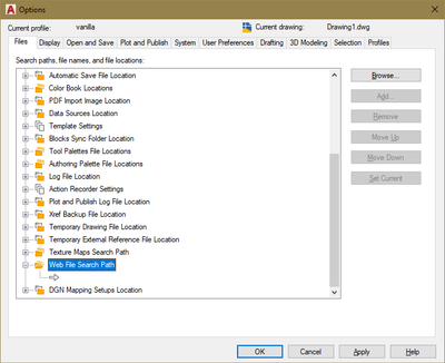

In Options, do you have an entry at Web File Search Path?
Message 3 of 10
stephen.hRREY7
It looks as though I do, what should that value be? The only thing I have done differently recently is open autocad at a job site, potentially offline.
Message 4 of 10
dmfrazier
"It looks as though I do, what should that value be? "
Well, I suppose you can have it be any valid path you like.
My "hunch" is that having it point to "anything" makes AutoCAD "look at" and attempt to "resolve" or verify any web addresses at that location.
So, you could try  removing the path (save it somewhere in case you need to put it back) and see if that "resolves" the error. If it doesn't, then we're barking up the wrong tree.
