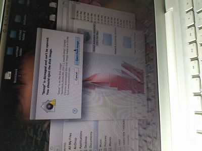

I'm not sure if this is the appropriate place for this, but unable to find anywhere else on Autodesk sites to request support.
Installing AutoCAD 2022 fails on Windows 10 machine, which has all the most recent updates.
After downloading, the installer runs until it gets to this point:

The file C:\Program Files\Common Files\Autodesk Shared\AcShellEx\AcShellExtension.dll is being held in use. Close that application and retry. .. Even a Reboot first would help
or
it looks like you have old version for SaveToWeb from 2021. Perhaps the fix is to uninstall SaveToWeb first. Then Install 2022.

Unable to uninstall existing 'Autodesk Save to Web and Mobile'

The picture you show is that you need the installation files of 2021 to uninstall existing Autodesk Save to Web and Mobile.

Yes the message I get is saying that it is having difficulties finding 2021 files.  But that message is a result of running the AutoCAD 2022 installer.
I've also run that fix-problems-that-block.... app, but that doesn't help.  One of the options in that program is to select the 'Having problems installing a program.  It then takes a few seconds and lists all of the apps already installed on my machine.  Unfortunately, the issue is trying to install an app not already on my machine AutoCAD 2022.
FYI, also ran into the same problem with the Revit 2022 installer.   This appears to be more of a problem with my machine, will let my IT department sort it out.

My installation issue was resolved by resetting my system to factory defaults.  i.e.  I needed to re-install, re-configure everything.  My system issues were not caused by the Autodesk installers.
