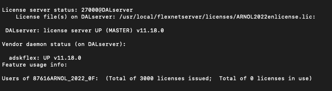

Recently I was granted educational access to Arnold 2022. To update the licensing server I shut it down, removed the old .lic file and added the new one and made sure upon starting the server that it points to the new licensing file.
On the client side, our student machines connect to the licensing server via Arnold License Manager. Everything is green, but when they do a batch render the "Arnold" watermark still appears. I have never ran into this issue before as everything  seems to report normal functionality.
We checked the Maya + Arnold render settings too "Skip license check" is disable.
Here is the current server status. Server + Client sides (screenshots below) - One thing I noticed is that the server side reports 27000 as the port and client side port is configured for 2080. Would this make any difference? We're operating in a MacOS environment (server and client)

I pulled 2 Arnold License Manager logs from a client rendering using the local NLM server. I get two different errors on each log. Tried changing the ports of the second go around, but no difference.
While rendering, there are watermarks, and on the server when checking the server status - no licenses are being handed out while a render is in progress.
Here is what I am getting:

You are receiving both a network license error -12 & -96 they both indicate an issue with the license server.
Make sure the Arnold version installed on the client machines matches up with the generated license file. Then, Follow the steps in the article under "Multi-user license (new install)".

I'm in contact with an Autodesk technician, configuration wise the Server and Client speak to each other. Versions of Maya 2022.3 and 2023 are rendering with  Arnold watermarks and do not grab licenses from the server, however Maya 2022 batch renders without issue. I tried clean installs of Maya 2022, and the NLM on both Client and Server, and no resolution yet.
The only work around so far is Render Sequence, which isn't ideal OR enable File output under the Diagnostic setting tab in the Arnold Render settings. For some reason this latter removes the watermark ( a bug maybe?)
Other than that we are hitting a roadblock.
The last advice from the technician was the following, which hasn't resolved our issue yet:
1. This is not a common or known issue, so there is no simple solution to this.
2. Even the PIT error is reported/noted only once (!), but also without a clear solution, but it's noted to be related to a delay/timeout
VendorID=6 [ADLMPIT]
VendorError=28 [Failed to encrypt the Product Information Table file]
Currently the assumption is that this is some sort of delay / timing issue and writing the log file is enough to make it work.
