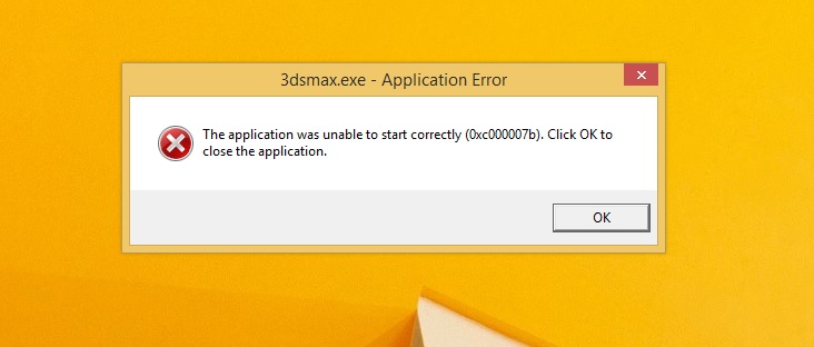

i installed 3dmax 2015 from the student version from Autodesk website, and after installing when i run the program i have a message tells that an error 0xc000007b error occured
please help me - URGENT

Hello @Anonymous
Try uninstalling the 2010 Microsoft Visual C++ from your system - there could be as many as 4 to uninstall.  Then reinstall them:
Microsoft Visual C++ 2010 SP1 Redistributable Package (x86)
http://www.microsoft.com/en-us/download/details.aspx?id=8328
Microsoft Visual C++ 2010 SP1 Redistributable Package (x64)
http://www.microsoft.com/en-us/download/details.aspx?id=13523
