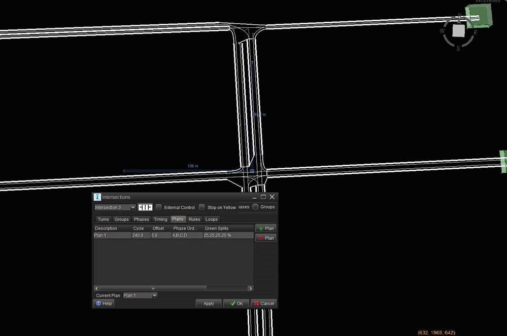

  5. When configuring a interseccions with lights, after configuring the turns, groups, phases and timing, there is a tab called Plans where offset can be set. My question is, if this value can be independent from the others? Because not always all the intersections are separated the same distance, so the offset should be different if green wave is desired.

3) Yes, absolutely. If you edit the intersection by double clicking on it, Plan settings can be defined per intersection independent from one another.

3) I think you didn't undestand my question. Specifically what I was asking was about creating a green wave in a model of 10 light intersections, but all the intersections are separated a different distance, and when I try to define a offset in the plan tab on one intersection and try to change it in other intersection, it changes the value in the first one. See the images below that, first, in intersection 3 I put 5 seconds offset and the on int. 4 I put 7, then return to 3 and it automatically appear 7.

1) In order to rename any intersection, right click on it and select Edit > Rename.
2) I have tested over and over the Plans issue scenario with a wide variety of offset values. It always works. I completely understand where you are coming from but I am not able to replicate it. Even with scrambled intersection names (not making sense from a modeling standpoint of view), the values are honored. Furthermore, once I simulate, not only the numbers are making sense, but the signals are modeled to the exact second. Kindly share your model with me as we absolutely need to get to the bottom of this.

4) Having said this, please use Mobility Simulation (not need to define a new area - just inherit it directly from Traffic Simulation), try again placing offsets on intersections and without even simulating, verify if the values hold. If not, save the *.aza file and send it to me. I will then be able to open it and check it.

First of all, I am glad that the Offset time is resolved for all intersections (your original request). I got your .aza files and I am able to load the entire network, thank you.
Secondly, the order in which intersections are displayed with the Adjust functionality does not impact the Offset time. It honors the offset based on the "origin" regardless of the order on Intersections.
Take a look at the images. Just with your naming convention, Intersection 3 at 8:04 is exactly where the phasing starts (tweaked groups and phases just to reproduce your scenario):
Now, at the same 8:04 on Intersection 6, cars do not move.
If Intersection 6 has a 10 second offset phase, then, exactly at 8:04:10 is when cars will start moving on Intersection 6 (previous intersection, Intersection 17 had a 5 second offset. It obeys Intersection3, not 17):
Finally, if you are adamant about re sequencing intersections and that makes you feel better (not necessary but certainly more comfortable as you are navigating using the Adjust command), then, start renaming Intersection 6 to a very high number, then 17 to another high number, and so on. Now that the Intersection 6 name is available, rename it and then all intersections will appear in the correct order.
