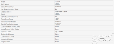

I have the same issue as Jeroen. Even when augmenting the frequency the results are not what to be expected:
The Corridor Surface on the contrary doesn't show any gaps:
Export/Import IMX of the Corridor Surface as the workflow you mentioned, results in the same: Surface without gaps.
It seems like IW is having issues with the treatment of assemblies with a depth/thickness:
All used subassemblies only have codes assigned to toplinks en top points, so it's strage IW creates 'vertical' geometry as shown above:
So, in my opinion, the only 'clean' workaround, is the 'old school' method: importing Corridor Surface as Terrain, and then using Coverages to apply materials.
Unless - as Jeroen stated - we are overlooking something 'obvious' 😉
