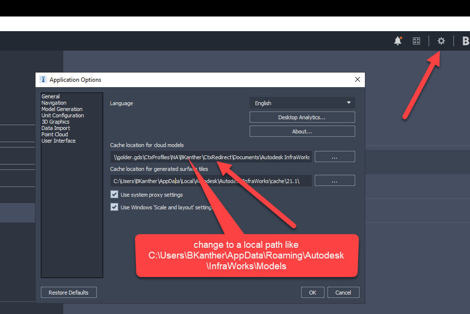

Well we have infraworks working fine in CITRIX with the exception of one little problem. Redirected user folders don't play nice
Infraworks typically places all the model data in a "persistent" cache location in /Documents/Autodesk Infraworks Models
But as you can see from screenshot below, the redirected path to documents causing all sorts of pain..
so only options are
1. "Create a mapped drive" like D or E that gos to the same path and change it to there.
or
2. map it to %APPDATA%, but there is a performance problem with this, because %appdata% gets copied back and forth after sign in sign out.. and IW projects can get >10gb really easily.. this will significantly slow down login/logout operations
Redirected folders dont workRedirected folders dont workmust be a local drivemust be a local drive
