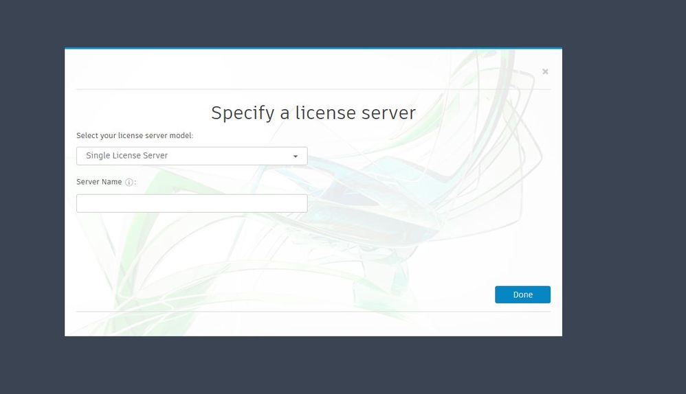

neilyj666
I'm running a standalone version and this pops up
I I hit the "X" it goes away and IW opens but I can't select any objects nad more worryingly it doesn't ask if I want to upgrade the model...!!!

tcorey
@neilyj666  You're getting the same error as I get. I do the same, click the X, which leads to InfraWorks opening.
InfraWorks does ask me to upgrade the model when I open one, but the advanced InfraWorks tools are disabled.
Maybe others reading this thread will want to hold off on installing 2022 until this is resolved. You can't have two versions installed like you can with Civil 3D.
