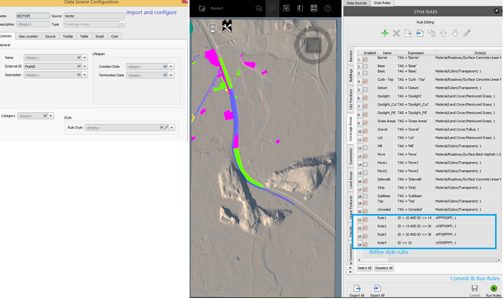

From steps you shared, I didn't quite sure if the style rule name is executable in data source dialog. Would it be an option to you to import all data in and then run style rules? If yes, here's what I recreate to this option:
  1. import SHP as coverage with blank configurations in rule style ( all data is imported )
  2. define style rules in Style Rules panel (same as your steps before data source configure, I added 4 rules with expressions of numeric attributes)
  3. click Commit button to save style rules Style Rules panel
  4. click Run Rules button at Style Rules panel
Then assets are colored with the style rule definitions. see snapshot below.
Can you try to see if it fits your needs?

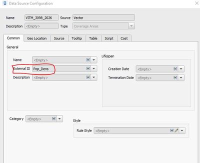

So, you use ID, which is a property found under Properties/Common in the Create Filter Expression. Is there a way to add the Pop_Dens property to that list. Otherwise the system doesn't really let you use it. I tried assigning to the imported shp the Pop_Dens to the External ID (see picture for clarification)
and then create and expression using that Extenal ID property.
Unfortunately, the rules do not apply properly. Only some polygons are coloured and they don't even get the correct values. Sorry, I'm a bit lost. Apologies if this is too dumb but I cannot figure out what I'm doing wrong here.

Thank you for sharing the model. I checked your proposal and found from model explorer -> coverage data table that, not all shp data imported as coverage when you specify 'Pop_Dens' as External ID.  So the style rules based on those records are incomplete.  The reason I feel is that  'External ID' isn't allow duplicated values, so it imports only distinct Pop_Dens.
