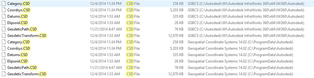

I found out that cs library stored in .csd (corect me if I'm wrong). I seached on my system have some .csd file. is it possible to replace csd from civil 3d (that have custom cs) to .csd in Infrawork? or change path so infraworks can read csd from civil 3d?

Civil 3D and Infraworks use collective CS folder. All CS, that you create and use in Civil  also available and in Infraworks
Choose your Category and you will see CS.
When create new model you  can set CS for display coordinates in the status bar (UCS) and set CS for database, i.e. for SQLite file your model. In details, see the pictures below:
