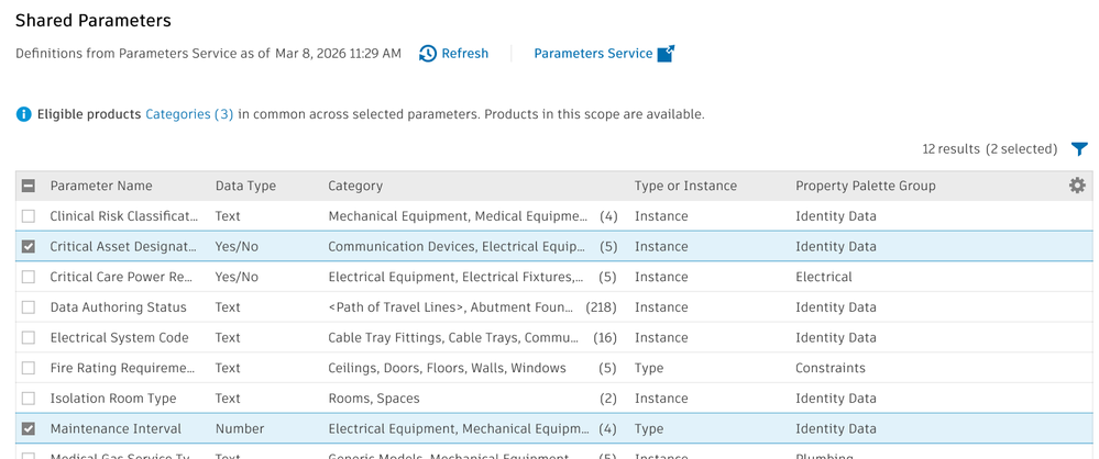

3. Select shared parameters
Switch to the Shared Parameters tab. This pulls parameter definitions directly from the Parameters Service in your Forma Hub — you're not creating new parameter definitions here, only choosing which existing ones belong to this standard. Select the checkbox next to each parameter you want to include. The filter (funnel icon, top right) narrows the list — already limited to the categories allowed by the hub’s existing shared parameters — further to specific categories. The gear icon lets you customize which columns are shown in the table.
You must select at least one shared parameter before you can save a draft — the platform won't let you save an empty standard.
Selecting hub-level parameters from the Parameters Service.Selecting hub-level parameters from the Parameters Service.
⚠️ The parameters you pick here can narrow your Product options later! See "Why don't I see the product I expected?" below before you move on to step 4.

Why don't I see the product I expected? (Shared Parameters ↔ Product tab interaction)
Selecting shared parameters can narrow what shows up in the Product tab. In the Parameters Service, each shared parameter lists a subset of Revit categories it is allowed to bind to.
Once you've selected parameters, the Product tab's release list is automatically scoped to products whose categories are within the allowed binding scope of all selected shared parameters.
Product's category must be in the allowable binding scope of all shared parameter selections.Product's category must be in the allowable binding scope of all shared parameter selections.
This is also enforced in the other direction: once you’ve selected a release on the Product tab, all shared parameters that do not bind to that product’s category are filtered out of the list on the Shared Parameters tab.
Shared parameters must bind to the selected product's category.Shared parameters must bind to the selected product's category.
You have the option to show these incompatible parameters in the list, but they won’t be selectable until the product’s category is added to their allowed binding scope in the Parameters Service.
Showing parameters incompatible with the selected product.Showing parameters incompatible with the selected product.
If your parameter selection has no category overlap at all, you'll see a clear error right on the Shared Parameters tab:
No product is compatible if no category overlaps all shared parameter selections.No product is compatible if no category overlaps all shared parameter selections.
If your selection narrows things down but doesn't eliminate everything, you won't see an error on the Shared Parameters tab — the Product tab will simply show fewer results than an unscoped browse would. Compare an unscoped Product tab (before any parameters narrow it):

Practical takeaway: if you go to the Product tab and don't see a product you expected, check which shared parameters you selected and what Revit categories they're tied to, before assuming something is broken.
After your second shared parameter selection on the Shared Parameters tab, an Eligible products message displays to inform you that your product options are now limited to only products in those categories that are common across the shared parameters you’ve selected.
Eligible product categories based on shared parameter selection.Eligible product categories based on shared parameter selection.
