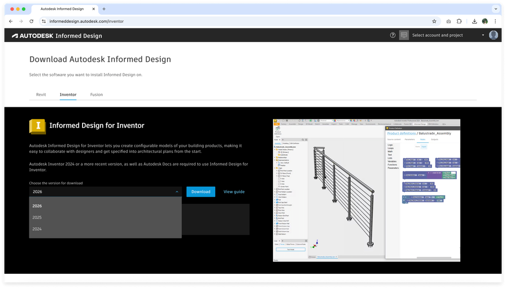

Informed Design Inventor Add-in Installation
To set up Informed Design for Inventor so you can author and publish product models for use within Revit follow these steps after installing Inventor 2024.2 or later:
  • Select Download Add-in for your Inventor version year. We support Inventor 2024, 2025 and 2026.
  • Click on the downloaded file named Informed Design Add-In X.XX.X.X for Inventor 202x.msi to launch the Informed Design Add-In Setup Wizard.
  • Follow the installation Wizard instructions to complete the add-in installation process.  **Make sure Inventor is not currently running before installing this add-in.**

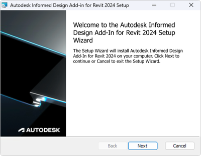

Informed Design for Revit Add-In Installation
To set up Informed Design for Revit so you can discover and design with published product models from Inventor, follow these steps after installing Revit 2024.2 or later:
  • Click on Revit tab.
  • Select Download Add-in for your Revit version year. We support Revit 2024, 2025 and 2026.
  • Click on the downloaded file named Informed Design Add-In X.X.X.X for Revit 202x.msi to launch the Informed Design Add-In Setup Wizard.
  • Follow the installation Wizard instructions to complete the add-in installation process.  **Make sure Revit is not currently running before installing this add-in.**
