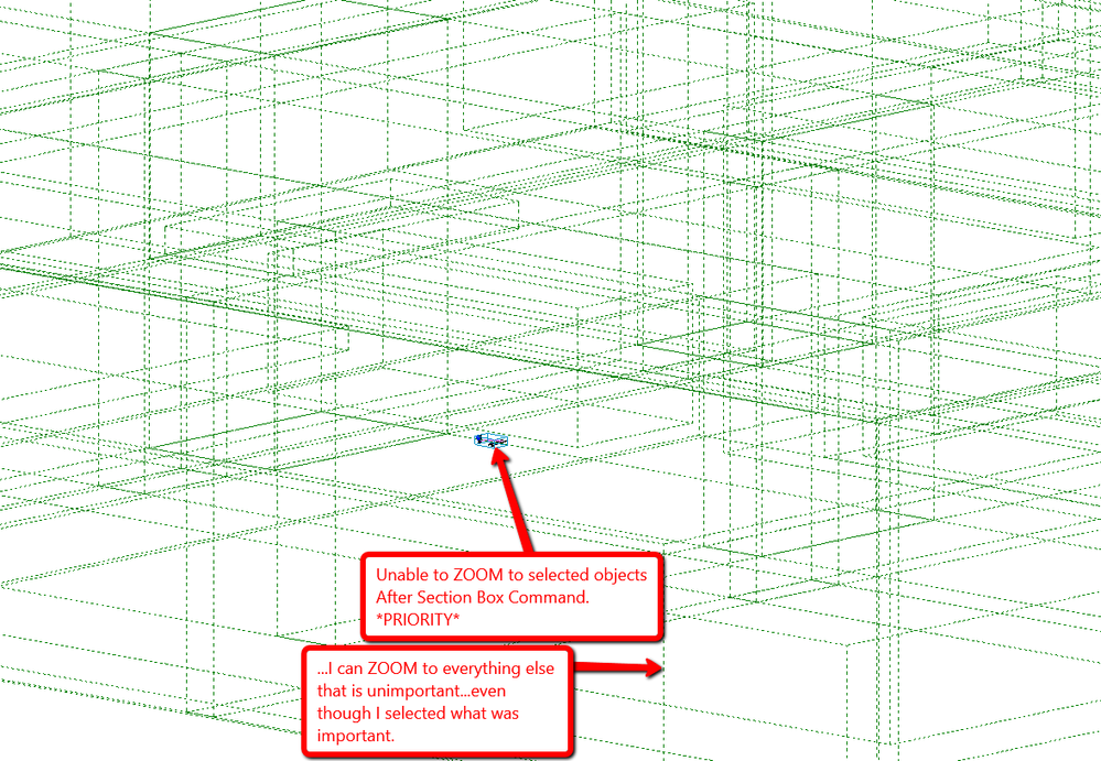

Zooming to a selected object would aid in the efficiency of coordinating. I've read the rebuttal of using Manage/Select By ID...but this is not a useful work flow it's a work for not having Zoom-To-Selection in Revit it is a work around. Manage/Select By ID is awesome across workflows from Navis back to Revit etc.. WTBS when you select an object in a heavily coordinated model and then choose the Section Box Command...GOD MODE happens and you see everything and nothing at the same time. This work flow requires you to the manually zoom into your selection. Why? It's such a waste of time to constantly be zooming in to your selection, when you're neck deep in coordinating and modeling...Zoom Selected is IN Navisworks Manage. It works as it should...Revit needs this functionality.Zoom_to_Select_3_001.png

Zoom to selection does exist: select something and click on the cube.
It works, but there is no keyboard shortcut and it may change the view orientation.
It does exist also in the APIs: UIDocument.ShowElements().
Making it an out-of-the-box command would be very easy.
I made my own command on my own add-in, and I can easily define a shortcut for it, but this is such a basic feature that should be part of the out-of-the-box toolset.
