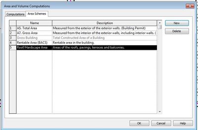

Can you clarify your idea/suggestion?
If you're referring to the Area Schemes, you can just make new ones.
(Architecture Tab --> Room & Area --> Drop-down menu --> Area and Volume Computations --> Area Schemes)
Sorry, i should said area type and not surface type.
Yes you can have different area schemes, but it is always base on the same area type (rentable or gorss)
