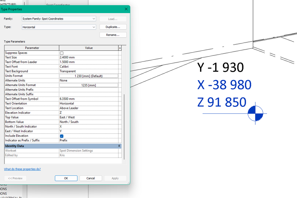

A workaround for this is place a small 3D family or a model line segment, which is disjoined from it's workplane/host, then add a Spot Coordinate with Elevation indicator set to (Z) change the EW to (X) and NS to (Y).
Clumsy but it can work.
