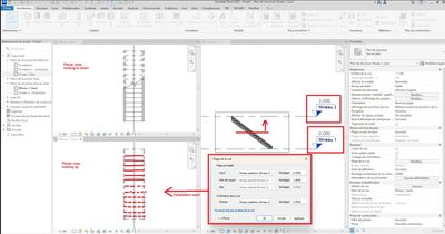

In France, we are used to formwork being displayed in plan view.
Unfortunately, the stairs are not well displayed even if I use right view range parameters.
I've made an example in Revit 2025 the screen capture below reports the display issue.
It will be great to integrate the right displaying for stairs (up view).
Also, you will find my example in attached file.
Best regards
Olivier

As for the formwork, we tend not to use stairs for stairs but use a generic family that cuts according to view limits.
There should be more graphical options for stairs in general. I would love to have more freedom with how my stairs look in plan or section
Hello everyone, I completely agree, this is a real problem in Revit today. To have a correct representation of the stairs, I am forced to redraw them in 2D in my plan view. This is quite counterproductive when we have taken the trouble to draw the stairs in 3D.
