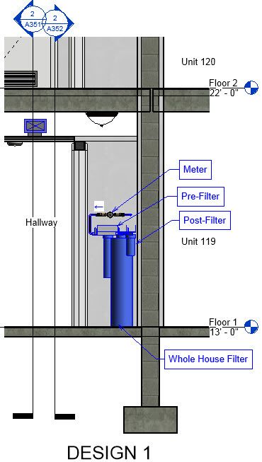

I am attaching three images to exemplify the outcome that I wish could be accomplished with phase specific text. The images are from just one of several views of a whole house water filtration system.
Image 1 is Design 1 which is the All Out Design that contains a water meter. The meter is on a phase. The text is not on a phase as how Revit currently functions.
Image 2 is Design 2 which is the Scaled Back Design that eliminates the water meter by changing the view’s phase. However, the text not being on the same phase remains in the view.
If the text label for the meter was on the same phase as the meter then simply changing the view’s phase would quickly and precisely make the view show the desired design as in Image 3.
If Revit had phase specific text there would be no need for duplicate views and sheets to deal with various design options.Image 1.jpgImage 2.jpgImage 3.jpg
