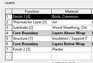

"Function" & "Priority" should they be split in Assembly's?
When I'm trying to choose how wall joins appear in plans, Revit will always prioritise keeping the structure connected - this isn't always desirable when you need a wall cavity to appear continuous. A way around this has been to change the function of the layers, to keep cavities, or insulation for example, and give them a [1] priority or similar, so they're higher up the order than the masonry supporting structure - but obviously you end up labelling "air" as structural.
Would it be beneficial to split the Function and Priority settings into separate entities? It's seems to be quite rare that I find the wall join option I need when cycling through the options.
