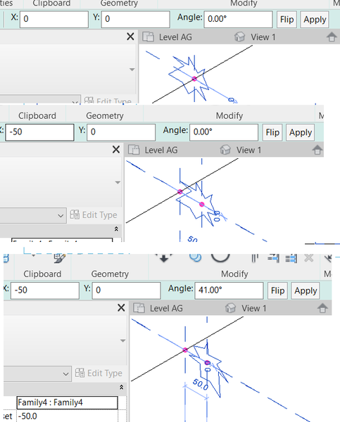

  • The ability to select snap points such as end point for RDC in the middle. In Below screen shot I am able to select the edge in View A, but require an end Point similar to how you can see the end point in View B. Currently, this can only be accomplished if I drew line or used reference planes... to find the required reference point originating from a RDC in the middle
  • The ability to specify a X and Y offset for 1 instance of the RDC which would then carry on through to the copies., similar to how you can do this using a profile in a extrude/sweep. Example: If I had a rectangle detail item drawn from the center I could move it to the edge or corner should I desire instead of having to redraw the DC with the correct origin point
screen shots show manipulation of a profilescreen shots show manipulation of a profile
