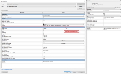

There is currently no way of using spot elevations without leaders and move it to the side of the elevation view. I know there is a box you can uncheck for leaders, but when the checkbox is ticked off the spot elevation moves back to the reference where it's placed. They just seem to be attached to the model item.
*I know you can lock lines to objects and place the spot elevation on the lines. but we place hundreds, sometimes even thousands of spot elevations per project. Which will be really time consuming to place and lock all of these (detail) lines.
(2)
Next to that it only has a solid line without a way to change it to a line of choice. (pictures down below).
^ (1a) before (checked box of leader)
^ (1b) after (unchecked box of leader)
^ (2) there is no easy way of changing line styles/types. ( you can only do this with override graphics in view, which actually takes days for some projects).
Hopefully there will be a solution for atleast one of the two options. (preffered both ofcourse)
