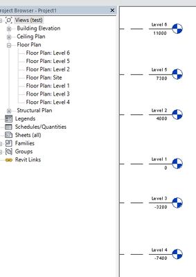

HI
Level,s Sort by height in PB. No characters.

Funny.... my colleague asked me the same today.
All you need is a "browser organization". Just do a right klick on "Views" in the PB -> "Browser Organization" -> "New"
Than on the Grouping an Sorting Tab -> Groupe by: Type and at the bottom Sort by Associated Level - Ascending or Descending.
Hit OK and be happy.
The only difference now is...the programm now writes the Type infront of the Name in the PB.
Hello
Yes I know. But I mean like the pictures attached.
Hi
Isn't it like i did in my post?
Don't be confused with the naming of the levels. If you compare the level name and the position in the PB you see that it starts with the lowest level (named level 4 cause i didn't care about the names in the testproject Guiño).
The sorting is actually what you want. And you can switch between ascending or descending for the sortings by hight (Associated Level).
If you want that value behind the name i don't have any cloue.
