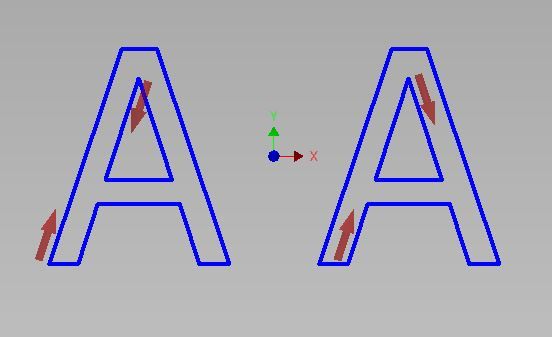

You need to select which side of the contour you want to cut? The red arrows show which side.

And, if you don't have the arrows on the correct side, click the arrow to change its direction.
