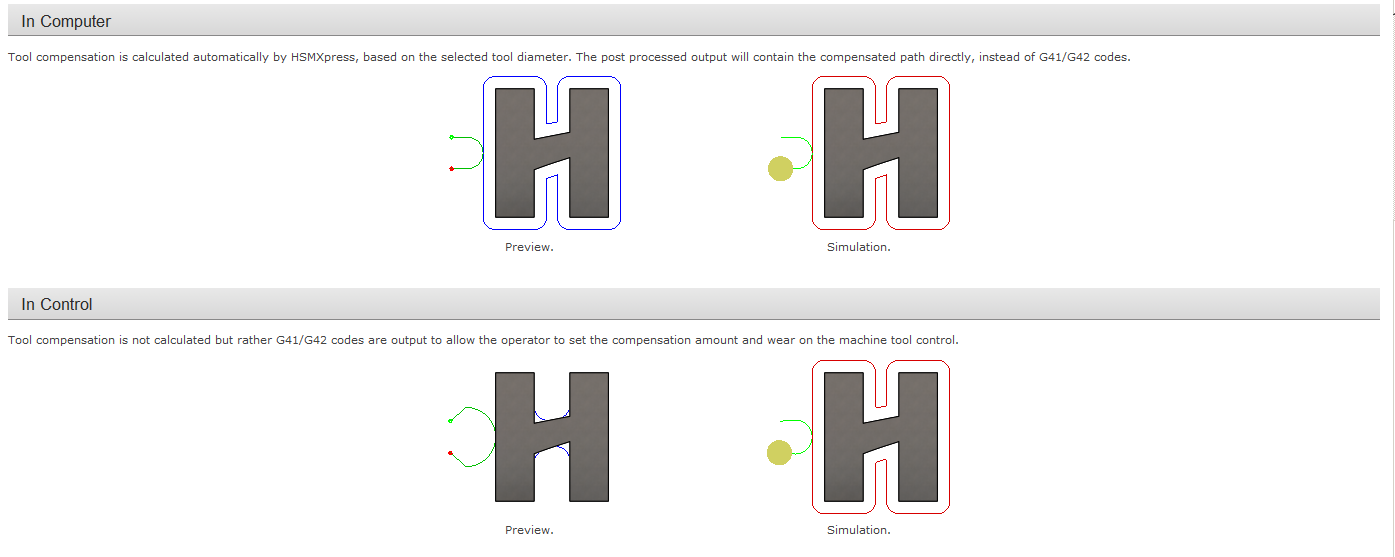

This is as desired - When Fusion shows a preview of the toolpath it is always the calculated (e.g. uncompensated) toolpath that is shown. The simulation and verification modes show the compensated toolpath as it would be run by the CNC machine.
And see some example image as below. Hope this is helpful for you!
Hansun
jeff.walters
Good graphics Hansun and correct. The only time the system will not show the tool compensated in Simulation is if you have Off selected as your comp type.
Actually what you say here is incorrect. Because there is nothing to compensate so it just shows the center of the tool which actually is a compensated value of the cutted edge.
But to keep things clear the simulation shows what the machine will be doing the preview shows what will be outputted by the post processor.(possibly with G-codes according to your choice.)
