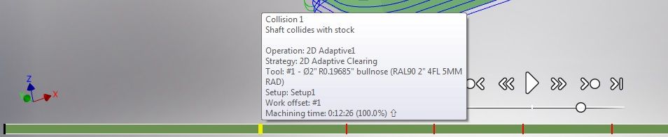

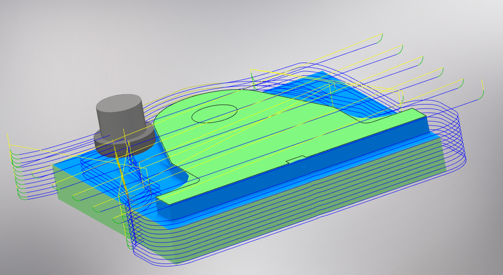

So I'm getting these egregious collisions with my model and can't figure out why they are happening.
I have restarted Inventor, restarted my PC, deleted and reloaded the file from Vault, and none of them have made a difference.
After restarting, the collisions are now in different locations than previously and there are more of them.
Any answers to solving this would help greatly.
Cheers!

Hello @jbthornhill and thanks for submitting your issue to the forum.  There is certainly some erratic behavior going on, as when I test your file on my machine the collisions appear in different areas.  As I roll my cursor of the collision in the simulation timeline, I do notice that it mentions the shaft of the tool being the cause of the collision.
This may be a tolerance issue within simulate as when I change the shaft diameter to be farther away from 2" (from 1.98" to 1.5") the collisions to not occur.
As a workaround, for the time being, can you lessen the tool shaft diameter?  I hope this helps for the time being.  I will investigate this a bit further with the development team and get back to you with what I find out.

After restarting, and reducing the tool shaft diameter, it doesn't appear to be an issue for the time being. I'd still like to see this get a better fix though, because my stock should NOT be touching the tool shaft at all.
