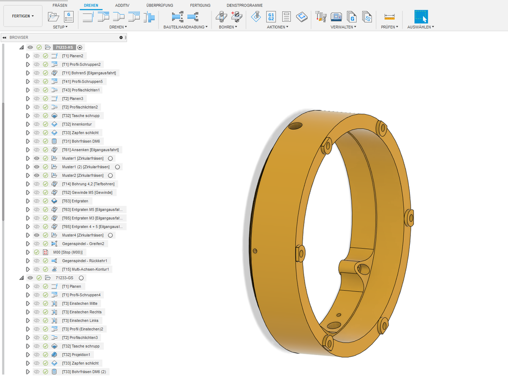

Hi, i am Marco from Austria
i am very interested in these post processors for the Okuma Multus, i have tried the post but there where some issues.
i got also a right NC Code and F3d File (manually changed which works perfectly on the Multus)

That would be great Marco. Happy to take a look and straighten things out.

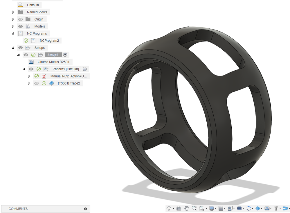

Screenshot (1).pngThank you for the response. We finally got our B250 running with the OSP300 control. I'm trying to chamfer some of our "windows" on our parts. I'd prefer to use XZC mode and the Action seems to not work at this moment. THEN gosiger applications department was taking a look at the NC post code and didnt care for the G52, he said thats old school and would be good to remove that. which we did manually. then at the end of the post "M109" I had to add a "M146" above it to work properly. Im also trying to get Trace to work but its not working with cutter comp which would be ideal so i can fine tune my chamfer but that doesn't regard to the post.
AND what is the difference between the b250IIc and b250IIW?
