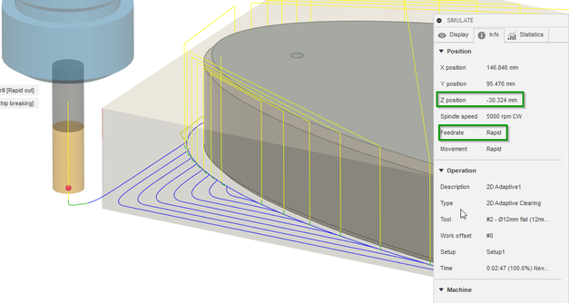

Hi
In the shown yellow marking, there is a wrong Z-command.
To go Z with a G0 command is not very good for the tool.
Why this command, it generate it only when i define an Adaptive tool path.

There is nothing wrong with using G0 Z-, as long as the toolpath is not programmed in a way that causes the tool to rapid into the material. If you have any doubts about the correctness of the toolpath, feel free to upload an image or Fusion model.
For example, in the case below, there is absolutely no issue.
