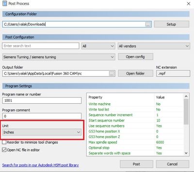

Can any one please suggest how do I modify the post processor of Siemens turning so that the feeds in the program are in feed/rev instead of feed/min? My CNC turning Center does not take G94 and I crashed a drill using G94 . Can i change something in post processor so that the drilling program contains G95 and Feed as feed/rev of the drill parameters?

Hi @Anonymous ,
Change the unit as an Inches and You will get G95 output. But if you want G95 only in a particular strategy then we need to change a few codes inside the post.

Well we use metric system here. I can change the codes in the post
processor if u tell me what needs to be changed.
Message 4 of 16
I tried changing the units to inches. But for drilling it still has the feed with G94 as shown as attached.
