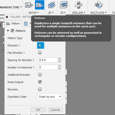

The Mach3 post processor does support subprograms for a repeated operation.  You need to enable the 'Use subroutine patterns' option when running the post.subprogram.png
And you need to make sure that your operation is patterned by creating a pattern folder and placing your operation in it.pattern.png
You should get a single subprogram in incremental mode for the operation and calls to the subprogram for the instances of the operation.
