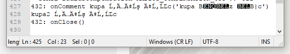

Screen from Notepad++:
So operation names are fine but dont know why but comments and writeln hardcoded unicode text are wrong.
